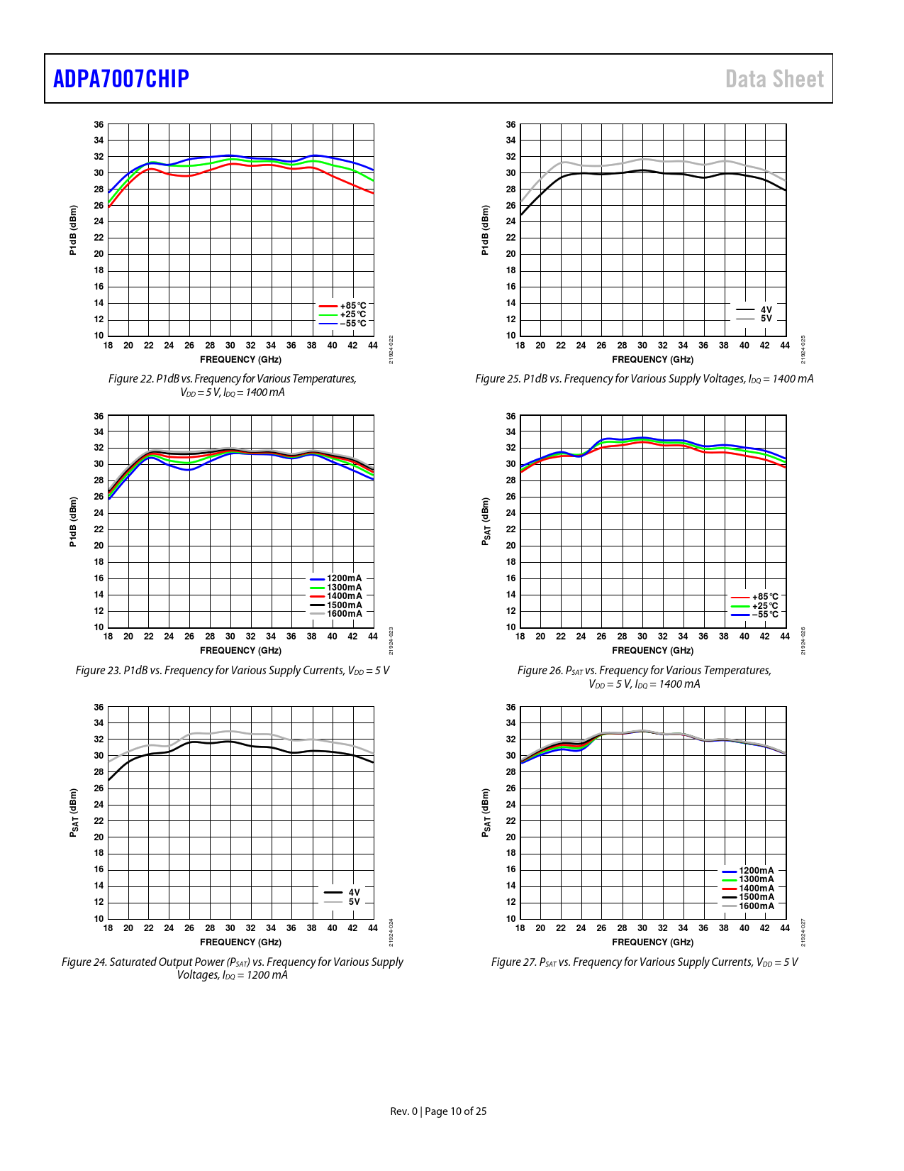

DescriptionGaAs, pHEMT, MMIC,1 W Power Amplifier, 18 GHz to 44 GHz

21924- Figure 22. P1dB vs. Frequency for Various Temperatures, Figure 25. P1dB vs. Frequency for Various Supply Voltages, IDQ = 1400 mA VDD = 5 V, IDQ = 1400 mA

21924- Figure 23. P1dB vs. Frequency for Various Supply Currents, VDD = 5 V Figure 26. PSAT vs. Frequency for Various Temperatures, VDD = 5 V, IDQ = 1400 mA

21924- Figure 24. Saturated Output Power (PSAT) vs. Frequency for Various Supply Figure 27. PSAT vs. Frequency for Various Supply Currents, VDD = 5 V Voltages, IDQ = 1200 mA Rev. 0 | Page 10 of 25 Document Outline FEATURES APPLICATIONS FUNCTIONAL BLOCK DIAGRAM GENERAL DESCRIPTION TABLE OF CONTENTS REVISION HISTORY SPECIFICATIONS 18 GHz TO 22 GHz FREQUENCY RANGE 22 GHz TO 36 GHz FREQUENCY RANGE 36 GHz TO 44 GHz FREQUENCY RANGE ABSOLUTE MAXIMUM RATINGS THERMAL RESISTANCE ELECTROSTATIC DISCHARGE (ESD) RATINGS ESD Ratings ADPA7007CHIP ESD CAUTION PIN CONFIGURATION AND FUNCTION DESCRIPTIONS INTERFACE SCHEMATICS TYPICAL PERFORMANCE CHARACTERISTICS CONSTANT IDD OPERATION THEORY OF OPERATION APPLICATIONS INFORMATION MOUNTING AND BONDING TECHNIQUES FOR MILLIMETERWAVE GAAS MMICS Handling Precautions Mounting Wire Bonding BIASING ADPA7007CHIP WITH THE HMC980LP4E APPLICATION CIRCUIT SETUP LIMITING VGATE FOR ADPA7007CHIP VGGx ABSOLUTE MAXIMUM RATING REQUIREMENT HMC980LP4E BIAS SEQUENCE Power-Up Sequence Power-Down Sequence CONSTANT DRAIN CURRENT BIASING vs. CONSTANT GATE VOLTAGE BIASING TYPICAL APPLICATION CIRCUIT ASSEMBLY DIAGRAM OUTLINE DIMENSIONS ORDERING GUIDE
