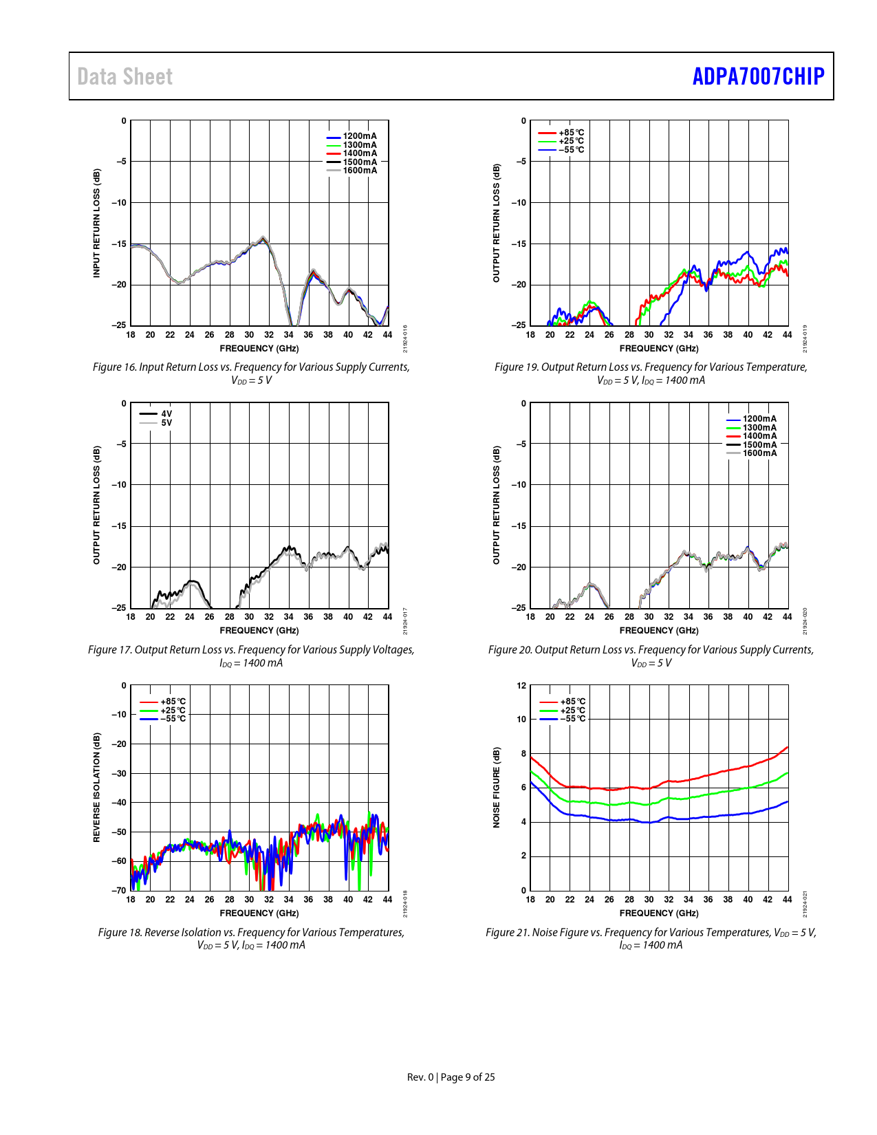

Data Sheet. ADPA7007CHIP. 1200mA. +85°C. 1300mA. +25°C. 1400mA. –55°C. 1500mA. 1600mA. –10. URN L. –15. INP. UT O. –20. –25. FREQUENCY (GHz). 4V 5V
Data Sheet ADPA7007CHIP 1200mA +85°C 1300mA +25°C 1400mA –55°C 1500mA 1600mA –10 URN L –15 INP UT O –20 –25 FREQUENCY (GHz) 4V 5V
Data Sheet ADPA7007CHIP 0 0 1200mA +85°C 1300mA +25°C 1400mA –55°C –5 1500mA –5 B) B) 1600mA d d ( ( S S S S O O –10 –10 URN L URN L T T –15 RE –15 RE UT UT P INP UT O –20 –20 –25 –25 18 20 22 24 26 28 30 32 34 36 38 40 42 44

21924- Figure 16. Input Return Loss vs. Frequency for Various Supply Currents, Figure 19. Output Return Loss vs. Frequency for Various Temperature, VDD = 5 V VDD = 5 V, IDQ = 1400 mA

21924- Figure 17. Output Return Loss vs. Frequency for Various Supply Voltages, Figure 20. Output Return Loss vs. Frequency for Various Supply Currents, IDQ = 1400 mA VDD = 5 V
0 12 +85°C +85°C +25°C +25°C –10 –55°C 10 –55°C ) B –20 (d ) N 8 dB IO ( T E A –30 R L 6 SO –40 FIGU E SE I OIS N 4 EVER –50 R 2 –60 –70 0 18 20 22 24 26 28 30 32 34 36 38 40 42 44

21924- Figure 18. Reverse Isolation vs. Frequency for Various Temperatures, Figure 21. Noise Figure vs. Frequency for Various Temperatures, VDD = 5 V, VDD = 5 V, IDQ = 1400 mA IDQ = 1400 mA Rev. 0 | Page 9 of 25 Document Outline FEATURES APPLICATIONS FUNCTIONAL BLOCK DIAGRAM GENERAL DESCRIPTION TABLE OF CONTENTS REVISION HISTORY SPECIFICATIONS 18 GHz TO 22 GHz FREQUENCY RANGE 22 GHz TO 36 GHz FREQUENCY RANGE 36 GHz TO 44 GHz FREQUENCY RANGE ABSOLUTE MAXIMUM RATINGS THERMAL RESISTANCE ELECTROSTATIC DISCHARGE (ESD) RATINGS ESD Ratings ADPA7007CHIP ESD CAUTION PIN CONFIGURATION AND FUNCTION DESCRIPTIONS INTERFACE SCHEMATICS TYPICAL PERFORMANCE CHARACTERISTICS CONSTANT IDD OPERATION THEORY OF OPERATION APPLICATIONS INFORMATION MOUNTING AND BONDING TECHNIQUES FOR MILLIMETERWAVE GAAS MMICS Handling Precautions Mounting Wire Bonding BIASING ADPA7007CHIP WITH THE HMC980LP4E APPLICATION CIRCUIT SETUP LIMITING VGATE FOR ADPA7007CHIP VGGx ABSOLUTE MAXIMUM RATING REQUIREMENT HMC980LP4E BIAS SEQUENCE Power-Up Sequence Power-Down Sequence CONSTANT DRAIN CURRENT BIASING vs. CONSTANT GATE VOLTAGE BIASING TYPICAL APPLICATION CIRCUIT ASSEMBLY DIAGRAM OUTLINE DIMENSIONS ORDERING GUIDE
