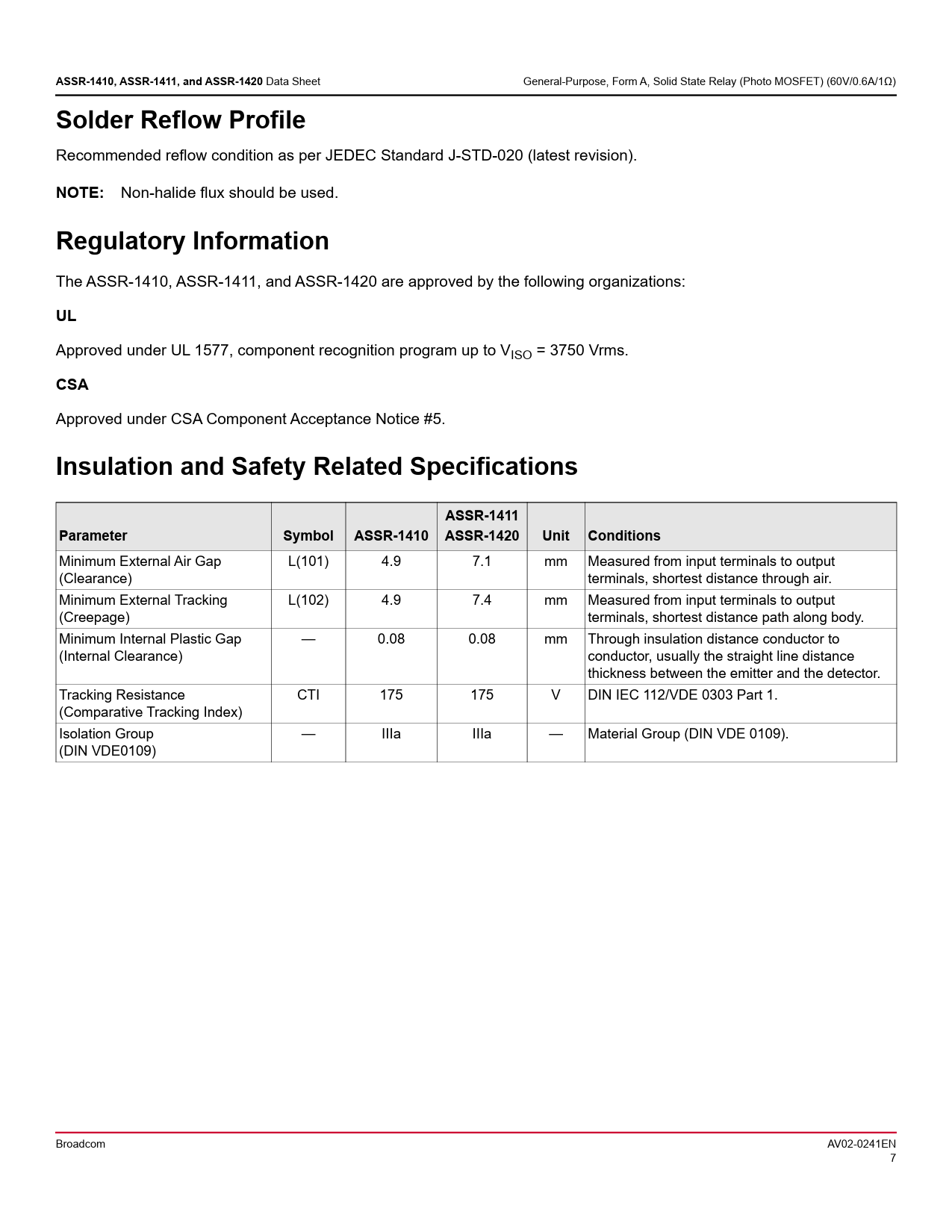

Data Sheet General-Purpose, Form A, Solid State Relay (Photo MOSFET) (60V/0.6A/1Ω)
Solder Reflow Profile
Recommended reflow condition as per JEDEC Standard J-STD-020 (latest revision).
NOTE:
Non-halide flux should be used.
Regulatory Information
The ASSR-1410, ASSR-1411, and ASSR-1420 are approved by the following organizations:
UL
Approved under UL 1577, component recognition program up to VISO = 3750 Vrms.
CSA
Approved under CSA Component Acceptance Notice #5.
Insulation and Safety Related Specifications ASSR-1411 Parameter Symbol ASSR-1410 ASSR-1420 Unit Conditions
Minimum External Air Gap L(101) 4.9 7.1 mm Measured from input terminals to output (Clearance) terminals, shortest distance through air. Minimum External Tracking L(102) 4.9 7.4 mm Measured from input terminals to output (Creepage) terminals, shortest distance path along body. Minimum Internal Plastic Gap — 0.08 0.08 mm Through insulation distance conductor to (Internal Clearance) conductor, usual y the straight line distance thickness between the emitter and the detector. Tracking Resistance CTI 175 175 V DIN IEC 112/VDE 0303 Part 1. (Comparative Tracking Index) Isolation Group — IIIa IIIa — Material Group (DIN VDE 0109). (DIN VDE0109) Broadcom AV02-0241EN7 Document Outline Description Features Applications Functional Diagram Truth Table Ordering Information Schematics ASSR-1410 ASSR-1411 Connection A ASSR-1411 Connection B ASSR-1420 Package Outline Drawings ASSR-1410 4-Pin Small Outline Package ASSR-1411 6-Pin DIP Package ASSR-1411 6-Pin DIP Package with Gull Wing Surface Mount Option 300 ASSR-1420 8-Pin DIP Package ASSR-1420 8-Pin DIP Package with Gull Wing Surface Mount Option 300 Solder Reflow Profile Regulatory Information Insulation and Safety Related Specifications Absolute Maximum Ratings Recommended Operating Conditions Package Characteristics Electrical Specifications (DC) Switching Specifications (AC) Applications Information On-Resistance and Derating Curves Turn-On Time and Turn-Off Time Variation
