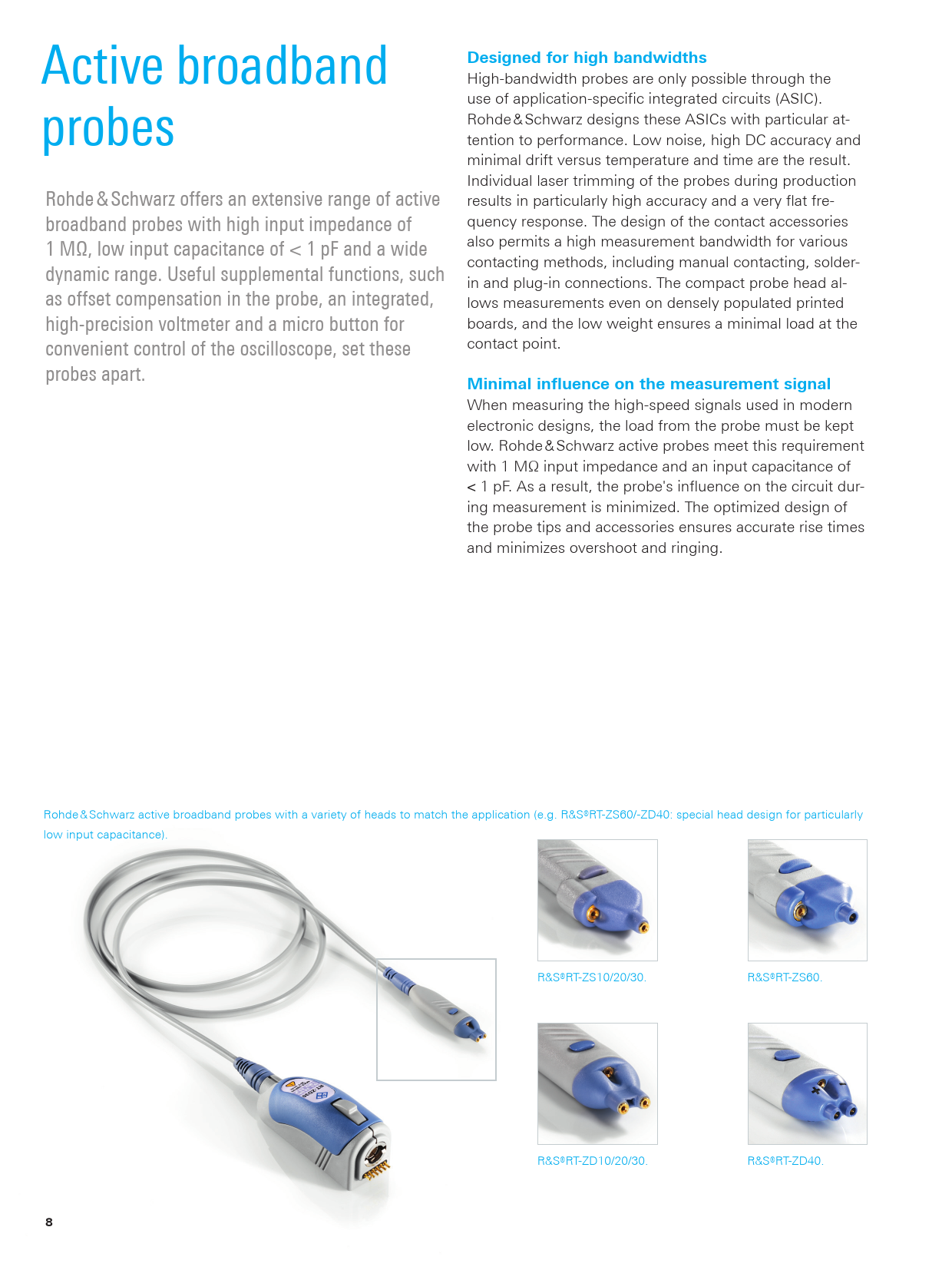

Designed for high bandwidths. Minimal influence on the measurement signal
Designed for high bandwidths Minimal influence on the measurement signal
Active broadband
High-bandwidth probes are only possible through the probes use of application-specific integrated circuits (ASIC). Rohde & Schwarz designs these ASICs with particular at- tention to performance. Low noise, high DC accuracy and minimal drift versus temperature and time are the result. Individual laser trimming of the probes during production Rohde & Schwarz offers an extensive range of active results in particularly high accuracy and a very flat fre- quency response. The design of the contact accessories broadband probes with high input impedance of also permits a high measurement bandwidth for various 1 MΩ, low input capacitance of < 1 pF and a wide contacting methods, including manual contacting, solder- dynamic range. Useful supplemental functions, such in and plug-in connections. The compact probe head al- as offset compensation in the probe, an integrated, lows measurements even on densely populated printed high-precision voltmeter and a micro button for boards, and the low weight ensures a minimal load at the contact point. convenient control of the oscilloscope, set these probes apart.
When measuring the high-speed signals used in modern electronic designs, the load from the probe must be kept low. Rohde & Schwarz active probes meet this requirement with 1 MΩ input impedance and an input capacitance of < 1 pF. As a result, the probe's influence on the circuit dur- ing measurement is minimized. The optimized design of the probe tips and accessories ensures accurate rise times and minimizes overshoot and ringing. Rohde & Schwarz active broadband probes with a variety of heads to match the application (e.g. R&S®RT-ZS60/-ZD40: special head design for particularly low input capacitance). R&S®RT-ZS10/20/30. R&S®RT-ZS60. R&S®RT-ZD10/20/30. R&S®RT-ZD40.
