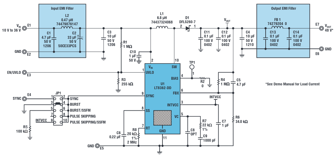

Schematic demonstration circuit DC2628 …
Schematic demonstration circuit DC2628 used to build a phantom power supply
Thomas Mosteller, Christopher Jarboe
Ultralow Noise, 48 V, Phantom Microphone Power Supply Using a Tiny DC-to-DC Boost Converter
Figure 1
70 Kb
Figure 1. Schematic demonstration circuit DC2628 used to build a phantom power supply
Figure 2. Сircuit with a capacitance multiplier (gray) at the output to suppress audio frequency noise produced by the switching regulator
