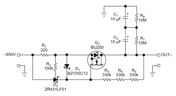

This modified version of the circuit in Figure 1 produces current using negative voltages
Produce current from positive or negative high-voltage supplies
Figure 1. This circuit produces current using positive voltages
Figure 2. This modified version of the circuit in Figure 1 produces current using negative voltages
