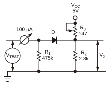

This simple circuit expands …
This simple circuit expands the acceptable test results to 90% of full-scale

Indicator features expanded scale
Figure 1. It's desirable to observe deviations in values inside the acceptable "green zone."
Figure 2. It's difficult to discern deviations from the norm when the green zone represents only 10% of full-scale
Figure 3. Expanding the green zone to 90% of full-scale makes readings much easier
Figure 4. This simple circuit expands the acceptable test results to 90% of full-scale
