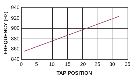

Frequency also varies with …
Frequency also varies with the tap position, but with no effect on performance

Figure 4. Frequency also varies with the tap position, but with no effect on performance
