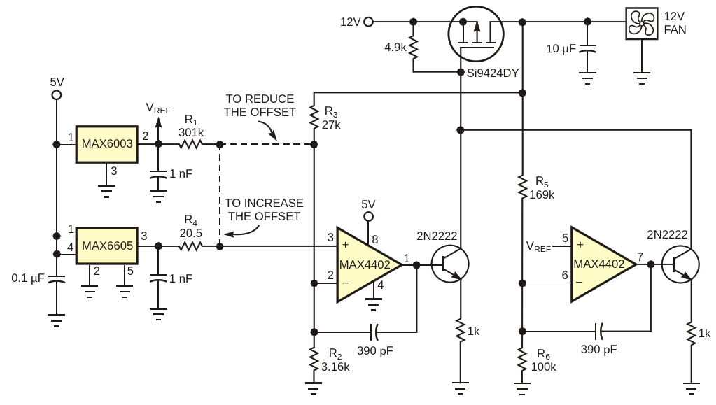

This circuit delivers a …
This circuit delivers a continuous and linear fan-control voltage that is proportional to temperature

Circuit generates fan-speed control
Figure 1
31 Kb
Figure 1. This circuit delivers a continuous and linear fan-control voltage that is proportional to temperature
Figure 2. These curves illustrate voltage output versus temperature for the circuit in Figure 1
