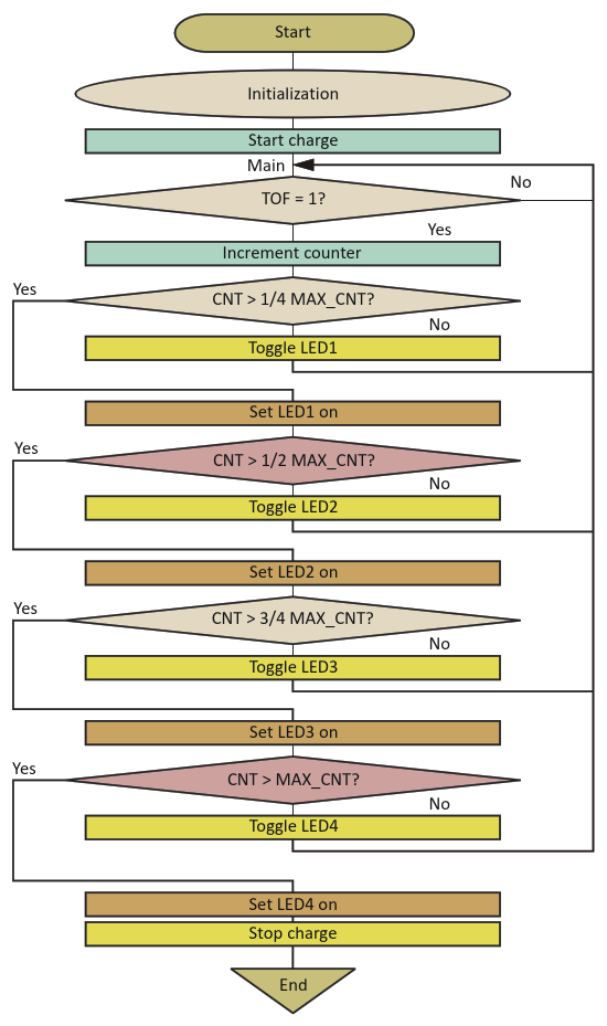

The flowchart shows the straightforward level-check/step-through iteration sequence of the code for driving the charge-indication LEDs

Figure 1. The constant charging current is produced by an LDO and resistor and gated by Q1, which in turn is managed by an output of the microcontroller. A quartet of LEDs, also microcontroller-driven, indicates charge status to the user
Figure 2. The flowchart shows the straightforward level-check/step-through iteration sequence of the code for driving the charge-indication LEDs
