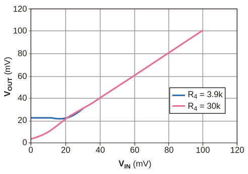

With 0.5-mA load current, …
With 0.5-mA load current, the output voltage is linear down to 4 mV

Figure 3. With 0.5-mA load current, the output voltage is linear down to 4 mV
