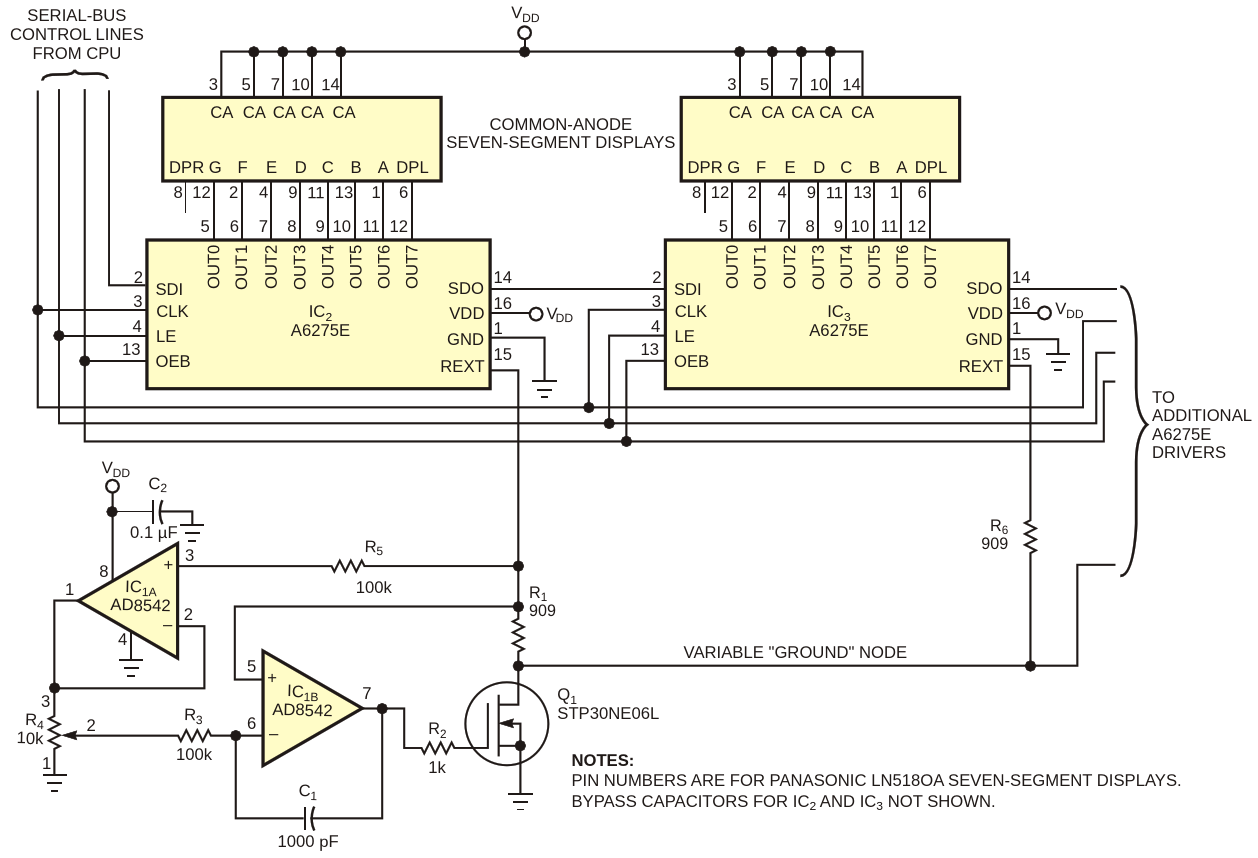

An analog control loop …
An analog control loop provides an adjustable "ground" node to control the current flowing through the resistors that set the segment currents
Stephan Goldstein
Circuit controls brightness of multiple displays
