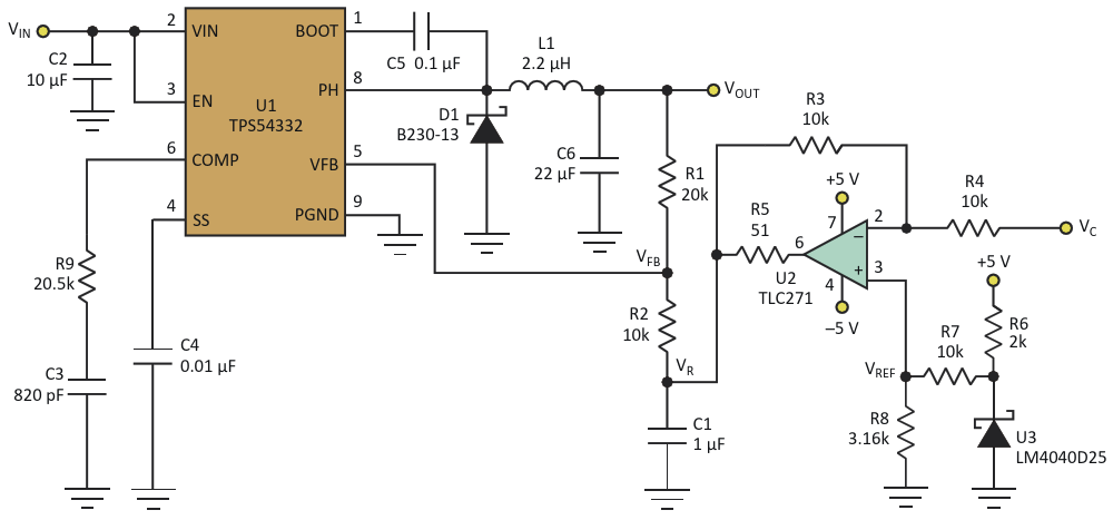

The added circuitry in …
The added circuitry in this version of the DC-DC converter permits control of V
OUT
by varying a control voltage, V
C
Eugene Palatnik
Simple Addition Permits Voltage Control Of DC-DC Converter's Output
Figure 2
32 Kb
Figure 1. The output voltage in a conventional dc-dc buck converter is fixed and depends on the resistor divider, R1/R2
Figure 2. The added circuitry in this version of the DC-DC converter permits control of V
OUT
C
