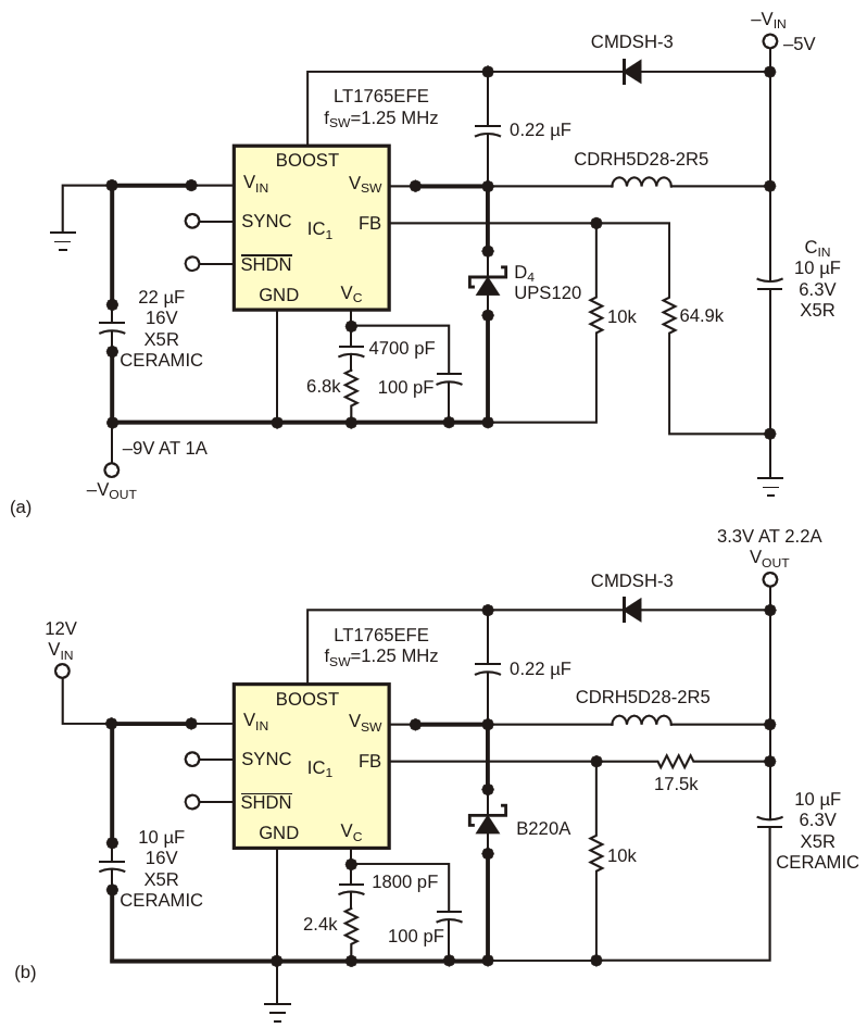

The LT1765EFE positive buck …
The LT1765EFE positive buck converter can make a negative boost converter (a) or a positive buck converter (b)

Positive regulator makes negative DC/DC converter
Figure 1
Figure 1. The LT1765EFE positive buck converter can make a negative boost converter (a) or a positive buck converter (b)
Figure 2. Efficiency of the negative boost converter in Figure 1a is as high as 85% and typically greater than 80%
