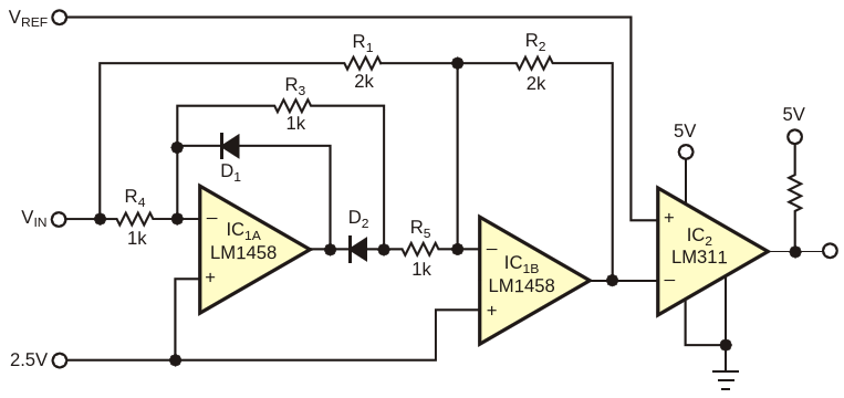

Absolute-value comparator touts accuracy, size

Figure 4. You can modify the circuit in Figure 2 to work with a single supply
