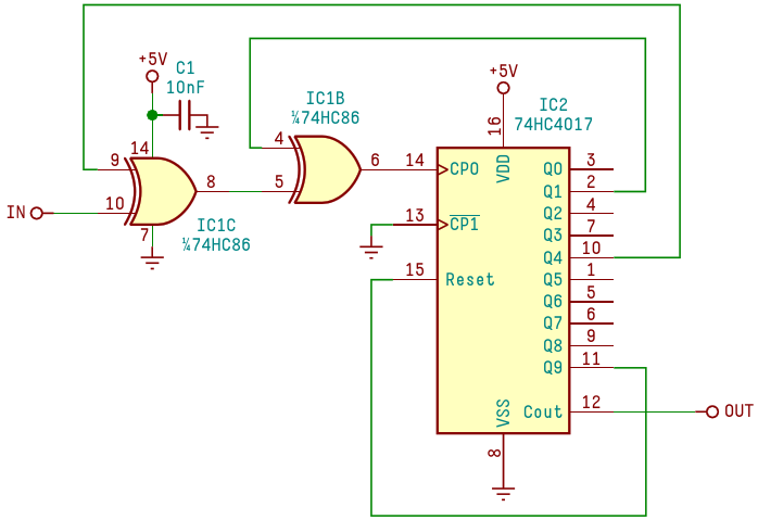

Adding another XOR gate …
Adding another XOR gate allows the circuit to provide a divide-by-seven with 50% duty cycle output

Figure 1. This design uses a Pierce oscillator based on an XOR gate and generates 455 kHz with 50% duty cycle
Figure 3. Adding another XOR gate allows the circuit to provide a divide-by-seven with 50% duty cycle output
