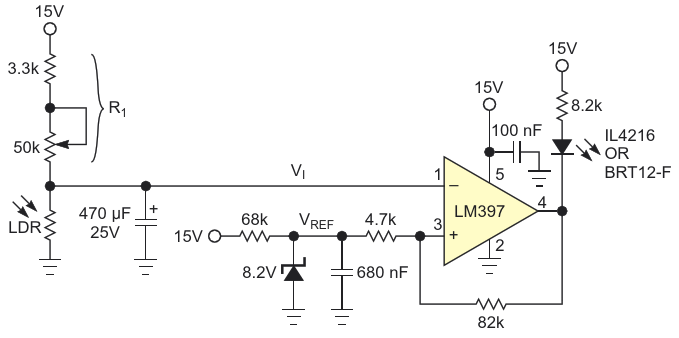

The circuit uses a …
The circuit uses a light-dependent resistor to measure the ambient-light level

Figure 1. This charge pump feeds the twilight switch from the ac line with high efficiency
Figure 2. The circuit uses a light-dependent resistor to measure the ambient-light level
Figure 3. The comparator drives a Vishay IL4216 or BRT12-F optocoupler with a TRIAC output
