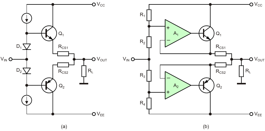

Power amplifier topologies with diode bias (a) and op-amp bias (b)

Figure 1. Power amplifier topologies with diode bias (a) and op-amp bias (b)
Figure 2. This current booster circuit delivers up to 20 W of power and exhibits a well-defined temperature- independent quiescent current
