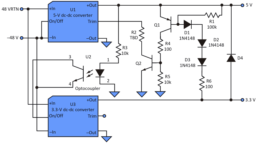

Adding an optocoupler (U2) …
Adding an optocoupler (U2) and a resistor to this power circuit is all that's needed to ensure the proper startup sequence of the 3.3- and 5-V converters
Alan Adamsky
Add two components to power supply to ensure proper voltage sequencing
