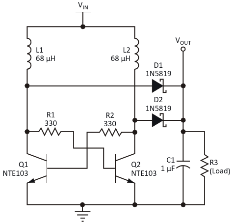

This open-loop boost circuit starts with as little as 260-mV input voltage

Germanium Dual-Boost Starts At 260 mV
Figure 1
Figure 1. This open-loop boost circuit starts with as little as 260-mV input voltage
Figure 2. The expected average output voltage is shown as input voltage increases. For light loads of more than 100 kΩ, an output voltage greater than 4.0 V is maintained for input voltages greater than 0.3 V
