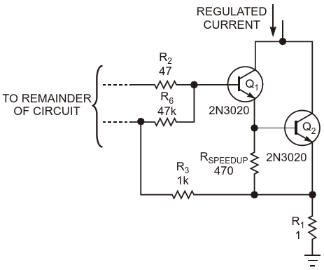

Adding RSPEEDUP improves the performance of a two-transistor Darlington output stage

Error compensation improves bipolar-current sinks
Figure 1. This typical quickly responding constant-current sink uses a bipolar transistor but suffers from base-current-induced error. Its normal output current is I

Figure 2. Adding base-current error compensation improves the circuit's performance. Using perfectly matched resistors simplifies the output-current equation to I

Figure 3. You can further simplify the current sink's design by adding only two resistors, R

, to the original in Figure 1. The output-current equation remains I

Figure 4. Adding RSPEEDUP improves the performance of a two-transistor Darlington output stage
