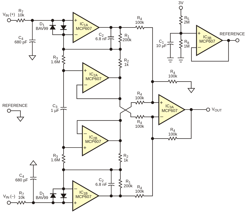

This high-CMRR instrumentation amplifier …
This high-CMRR instrumentation amplifier operates from extremely low supply voltages

High-CMRR Instrumentation Amp Works with Low Supply Voltages
Figure 1. Capacitor C ac-decouples the simplified amplifier circuit (a); the detailed circuit (b) uses gain stages and an adder-subtracter stage
Figure 2. This high-CMRR instrumentation amplifier operates from extremely low supply voltages
