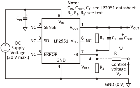

Create a Versatile Voltage-Controlled Voltage Regulator Based on the LP2951
Figure 1
34 Kb
Figure 1. Transform a conventional circuit into a much more versatile and flexible voltage regulator
