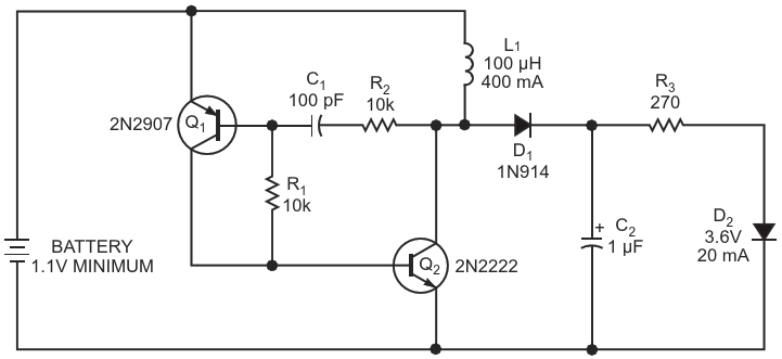

In this circuit, transistors …
In this circuit, transistors Q
1
and Q
2
form a flip-flop that toggles at 60 kHz, providing a drive current for the output LED down to the 1 V battery voltage.

White-LED driver operates down to 1.2V supply voltage
Figure 1.
