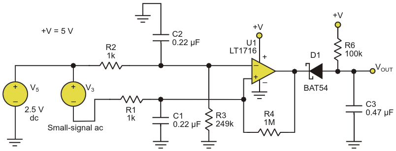

A conventional circuit uses …
A conventional circuit uses a diode after the comparator to rectify the output onto C3
Glen Brisebois
Asymmetric Output Into Capacitor Load Turns Capacitor Into Ideal Diode
Figure 1
22 Kb
Figure 1. A conventional circuit uses a diode after the comparator to rectify the output onto C3
Figure 2. Because U1 incorporates an asymmetric output stage (weak-pull-up/strong-pull-down), the improved circuit does not require a diode, which eliminates the forward diode voltage drop
