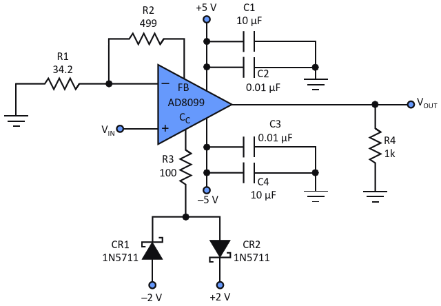

This circuit uses the …
This circuit uses the AD8099 amplifier IC in an unconventional way, connecting a clamping network to the amplifier's compensation pin
John Ardizzoni
Clamping Circuit Lowers Distortion, Improves Overdrive Recovery Time
