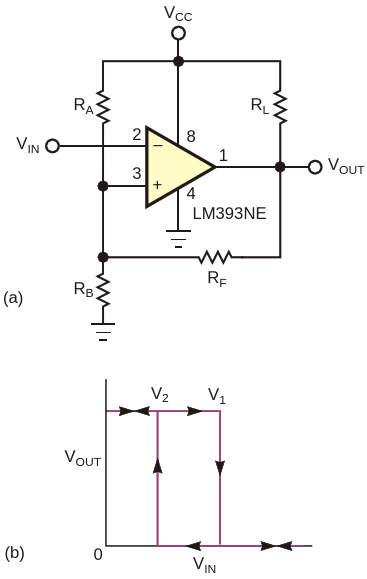

Three resistors determine the …
Three resistors determine the trip voltages of an inverting comparator (a) with hysteresis (b), but the trip voltages are not independent

Comparator has Independent Trip Voltages
Figure 1. Three resistors determine the trip voltages of an inverting comparator (a) with hysteresis (b), but the trip voltages are not independent
Figure 2. Using a dual comparator with open-collector outputs allows you to set either trip voltage without affecting the other
