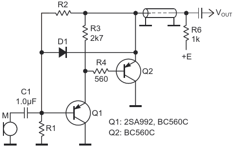

Very Simple Amplifier with Phantom Power
Figure 2
16 Kb
Figure 1. A simple amplifier circuit suited for inductive sources such as a dynamic microphone, transformer or inductance sensor/pick up
Figure 2. The modified circuit to get a gain of about 1
