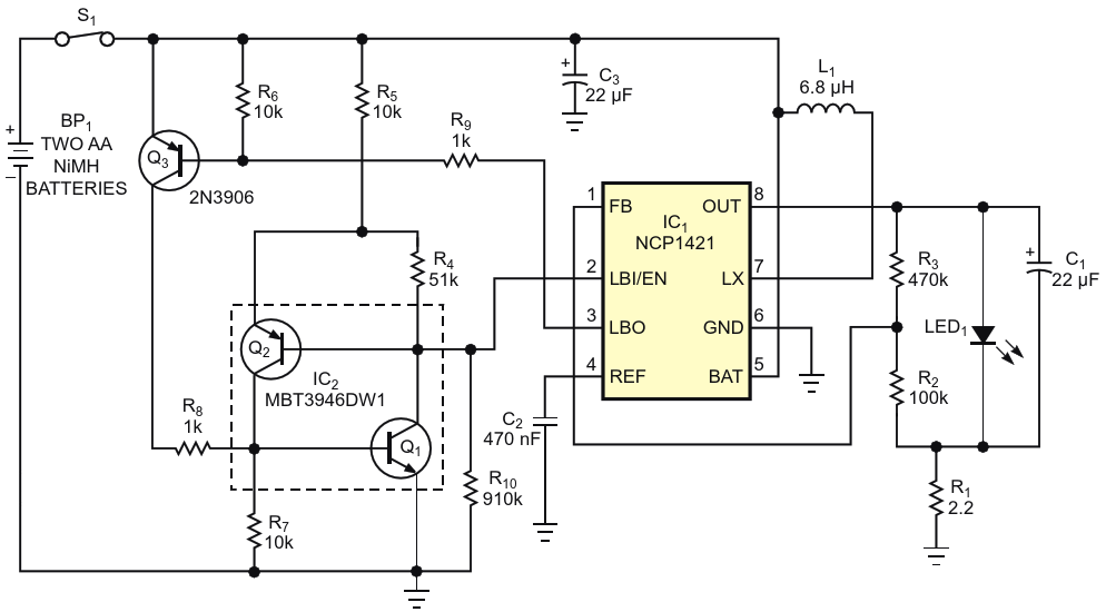

This circuit extends the …
This circuit extends the lives of rechargeable batteries by removing power at a preset voltage and preventing overdischarge

Automatic Latch-Off Circuit Saves Batteries
Figure 1
