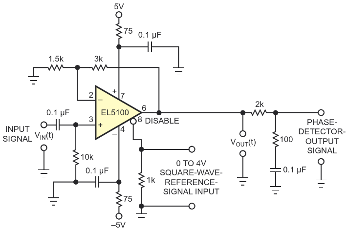

By switching the disable …
By switching the disable input of the op amp at a reference frequency and lowpass-filtering its output, you can obtain a dc voltage proportional to the phase difference of the switching frequency and the input frequency
W Bruce Warren
Switched-gain op amp serves as phase detector or mixer
Figure 1
