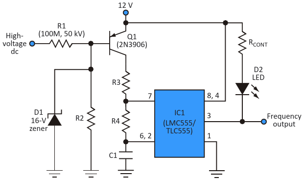

As shown, the dc high-voltage drop detector/undervoltage alarm uses an LED for a visible indication, but the LMC555/TLC555 can also be connected to a speaker for an audible alarm
