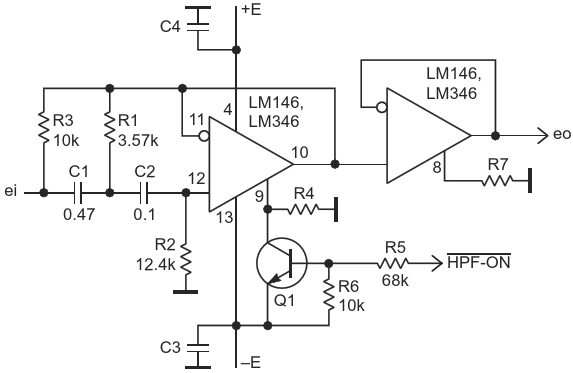

A Sallen-Key HPF filter …
A Sallen-Key HPF filter topology that can be switched on/off using an extra transistor and resistor

Simple switchable filter
Figure 1. A Sallen-Key HPF filter topology that can be switched on/off using an extra transistor and resistor
Figure 2. A LPF topology that can be switched on/off by using unipolar power and a transistor Q1 (SRC1204) with built-in bias resistors
