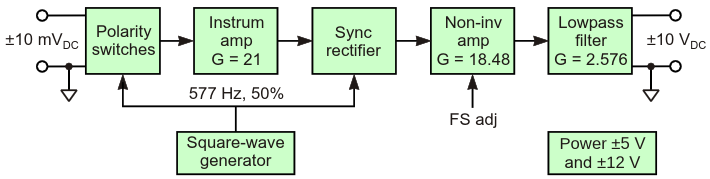

Precision synchronous detection amplifier facilitates low voltage measurements
Figure 1. Block diagram of the amplifier
Figure 2. Circuit schematic of part of the amplifier (filter is presented separately below)
