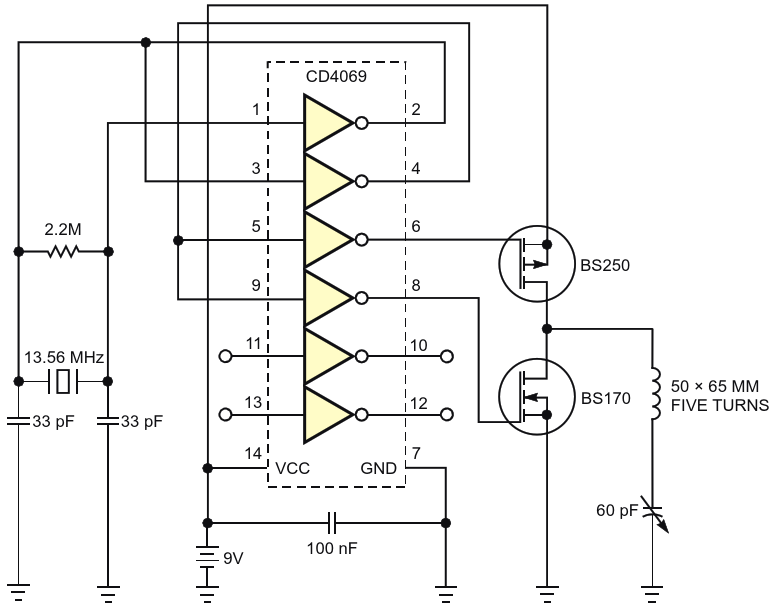

A simple 13.56-MHz oscillator energizes an antenna coil, broadcasting power to the receiving circuit in Figure 2

Figure 1. A simple 13.56-MHz oscillator energizes an antenna coil, broadcasting power to the receiving circuit in Figure 2
Figure 2. This receiver rectifies the signal from the oscillator in Figure 1, powering low-current consumer gadgets
