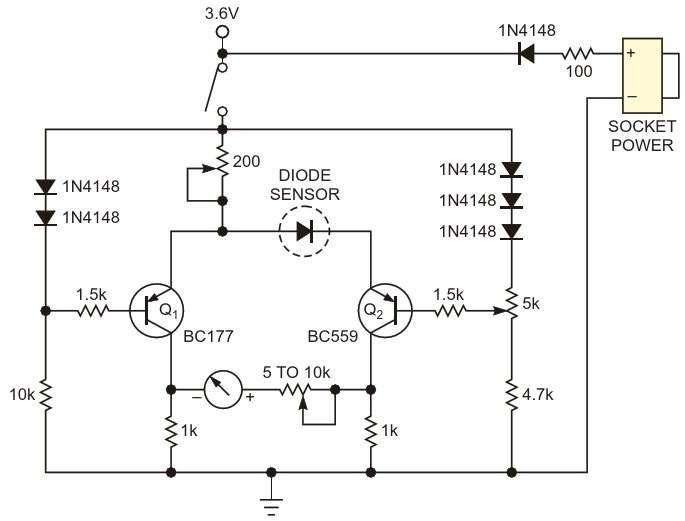

In this two-transistor thermal …
In this two-transistor thermal probe for diagnosing circuit problems, such as hot components and thermal runaway, the trimming potentiometer in series with the meter lets you adjust the sensitivity of the meter to temperature changes
Raju Baddi
Simple diode serves as a sensor for a thermal probe
