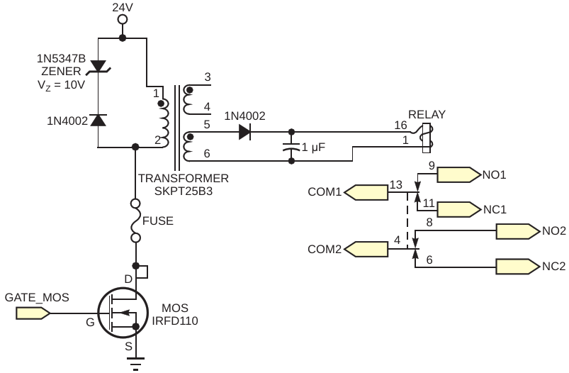

A "dynamic-variable" signal drives …
A "dynamic-variable" signal drives the output relay in this circuit

Oscillating Output Improves System Security
Figure 2
15 Kb
Figure 1. You can improve the reliability of an electronic-control output by using an oscillating, instead of steady-state, signal to represent a logic-high state
Figure 2. A "dynamic-variable" signal drives the output relay in this circuit
