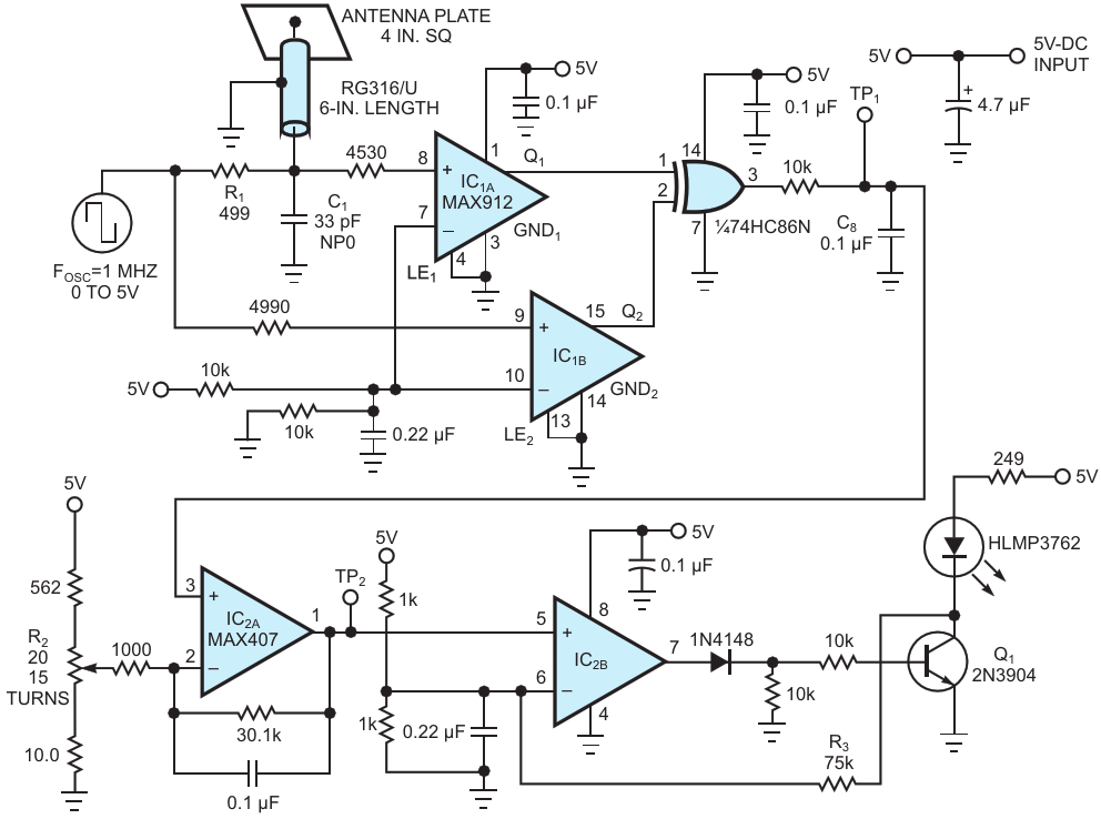

This proximity detector lights …
This proximity detector lights the LED when a person approaches the antenna plate within a threshold distance set by potentiometer R
2
Arthur Harrison, Joseph Stern
Dual comparators stabilize proximity detector
Figure 1
22 Kb
Figure 1. This proximity detector lights the LED when a person approaches the antenna plate within a threshold distance set by potentiometer R
2
Figure 2. Exclusive-ORing two inputs, one delayed by the R
1
-C
1
network, and subsequent filtering by R
2
and C
2
implements a capacitance-to-voltage conversion
