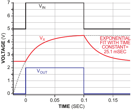

The output of the anticipator jumps immediately to the asymptotic limit of a rising or falling exponential transducer response

Simple anticipator circuit improves on earlier idea
Figure 1. This RC circuit models a single dominant time-constant transducer, producing a rounded, intermediate voltage, V
X
, in response to an input signal, V
IN
. With V
X
as its input, the anticipator circuit reconstructs the original
Figure 2. The reconstruction of the input sawtooth waveform shows that the circuit can operate properly with complex, possibly repetitive waveforms
Figure 3. The output of the anticipator jumps immediately to the asymptotic limit of a rising or falling exponential transducer response
