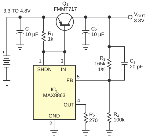

Unorthodox transistor connections to a low-dropout regulator allow you to squeeze a 100-mV dropout voltage down to 10 mV

Figure 1. Unorthodox transistor connections to a low-dropout regulator allow you to squeeze a 100-mV dropout voltage down to 10 mV
Figure 2. Dropout voltage for the circuit in Figure 1 varies from 10 mV at 100 mA to 90 mV at 1 A
