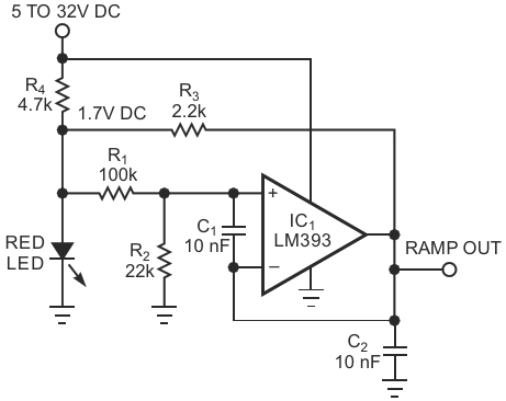

Use a low-cost PWM ramp generator in switch-mode power supplies
Figure 1
11 Kb
Figure 1. You can use a PWM ramp generator in low-cost switch-mode dc/dc power supplies
Figure 2. A 70 V-dc upconverter employs the ramp generator
