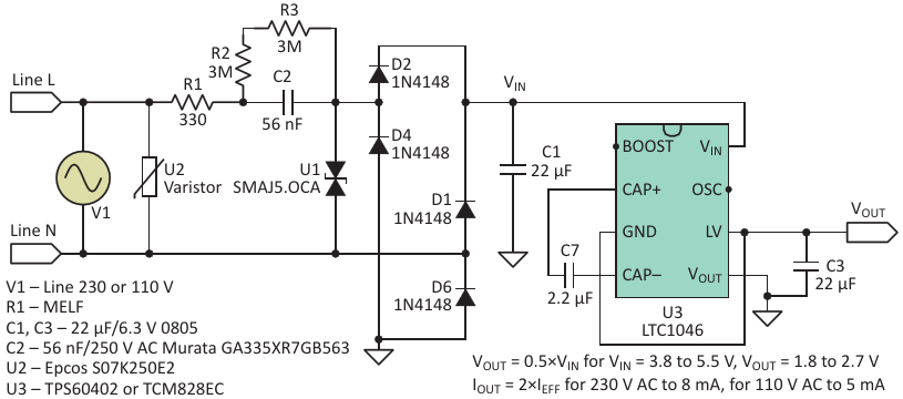

Topology implements updated version of non-isolated capacitive power converter

Figure 2. The modified capacitive converter with bridge rectifier adds additional regulation and protection
