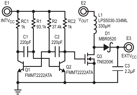

Boost controlled by astable …
Boost controlled by astable multivibrator is used for V
OUT
lower than 2.5 V

Figure 3. Boost controlled by astable multivibrator is used for V
OUT
lower than 2.5 V
