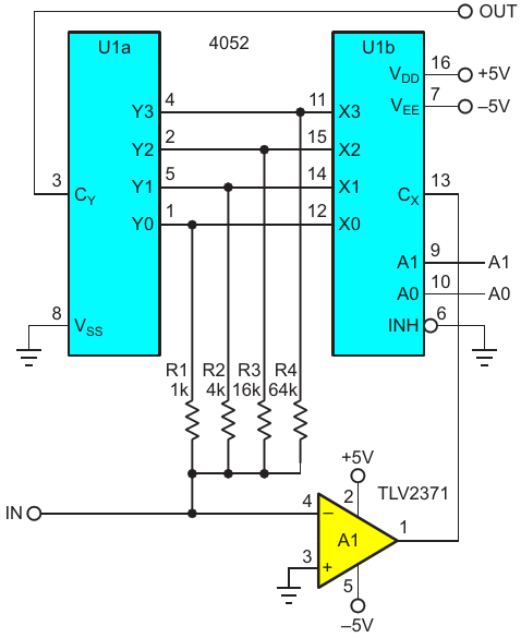

Canceling mux R
ON
error …
Canceling mux R
ON
error by taking the output signal from the gain resistor side of switches
Stephen Woodward
Make gain-control multiplexer R
ON
and R
OFF
errors (mostly) disappear
Figure 1
11 Kb
ON
and R
OFF
Figure 1. Canceling mux R
ON
Figure 2. Canceling mux R
OFF
error by the routing leakage current to ground with R
Z
