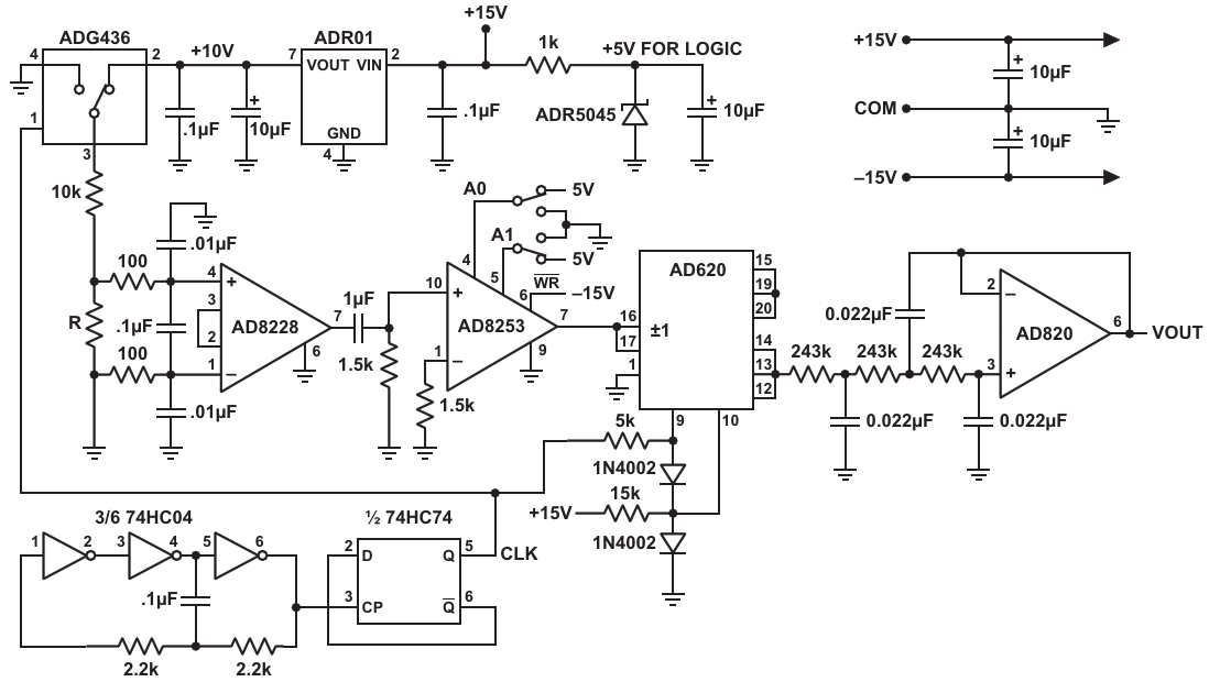

The AD8253 is configured …
The AD8253 is configured in transparent gain mode, allowing the gain to be manually set by the user according to Table 1
Moshe Gerstenhaber, Mark Champion

Complete, low-cost, software programmable ohmmeter measures micro-ohms
Figure 1. The AD8253 is configured in transparent gain mode, allowing the gain to be manually set by the user according to Table 1
Figure 2. The output voltage of the system for various lengths of 18 AWG copper wire has a resistance of 213.58 μΩ/cm, as measured in the laboratory
Figure 3. The measurement error of the system, where the noise in the curve is due to the human error in placing the measurement leads, and the slope of the curve is due to a slight system gain error
