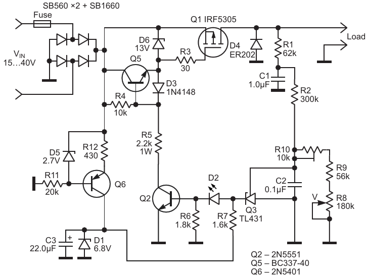

An efficient and simple regulator for heating/lighting purposes
Figure 2
16 Kb
Figure 1. A simple regulator for heating or lighting purposes, the circuit can be used to regulate heating processes with thermal inertia such as a soldering iron, hot wire cutter, heaters, etc
Figure 2. Another regulator that is well-suited for heavier loads on the order of 100 W
