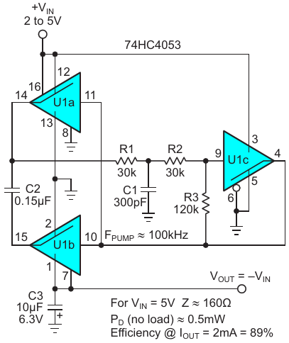

The generic and versatile …
The generic and versatile xx4053 provides the basis for a cheap, efficient, and accurate voltage inverter
Stephen Woodward
A simple, accurate, and efficient charge pump voltage inverter for $1 (in singles)
Figure 1
21 Kb
Figure 1. The generic and versatile xx4053 provides the basis for a cheap, efficient, and accurate voltage inverter
Figure 2. 100 kHz timing signals generated by the U1c Schmidt trigger oscillator
Figure 3. V
OUT
and power conversion efficiency versus output current for +V
IN
= 5 V
