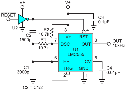

Gated 555 astable hits the ground running

Figure 1. Typical gated (via RESET pin) 555 astable multivibrator
Figure 2. Excessively long first pulse occurs on oscillation restart due to C1 complete discharge
Figure 3. Added timing capacitor C2 immediately precharges C1 to V+/3 trigger level when RESET returns high normalizing the duration of the first oscillation cycle
Figure 4. C2 charge injection on oscillation startup equalizes pulse length
Figure 5. A buffer may be necessary to provide a full voltage excursion RESET signal
