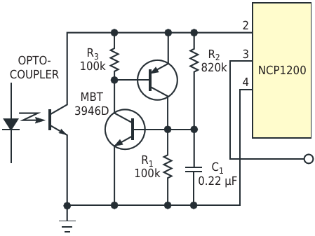

You can use a dual npn+pnp to build a cheap thyristor (a). When the thyristor fires, the pulses permanently stop, leaving no voltage runaway (b)

Bipolars provide safe latch-off against opto failures
Figure 1. A typical current-mode architecture uses an optocoupler as a variable resistor
Figure 2. In this battery-charger circuit, the primary controllers operate without any auxiliary winding (a). Output-voltage runaway can damage the output capacitors if the condition lasts too long (b)
Figure 3. You can use a dual npn+pnp to build a cheap thyristor (a). When the thyristor fires, the pulses permanently stop, leaving no voltage runaway (b)
