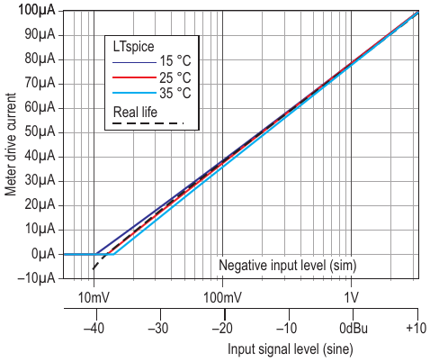

Simulated and measured responses …
Simulated and measured responses when set up for a 50 dB span with a +10 dBu maximum reading, showing the effects of temperature and op-amp offset

Figure 3. Simulated and measured responses when set up for a 50 dB span with a +10 dBu maximum reading, showing the effects of temperature and op-amp offset
