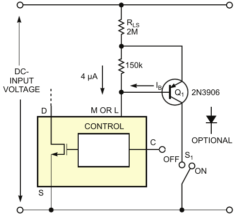

Instead of using just …
Instead of using just the external transistor to switch a TOPSwitch on or off, a simple on/off switch provides manual on/off control

Add a grounded-switch feature for TOPSwitch on/off control
Figure 2
13 Kb
Figure 1. Adding transistor Q
R
to the L pin of a TOPSwitch switching power controller enables an on/off-control feature
Figure 2. Instead of using just the external transistor to switch a TOPSwitch on or off, a simple on/off switch provides manual on/off control
